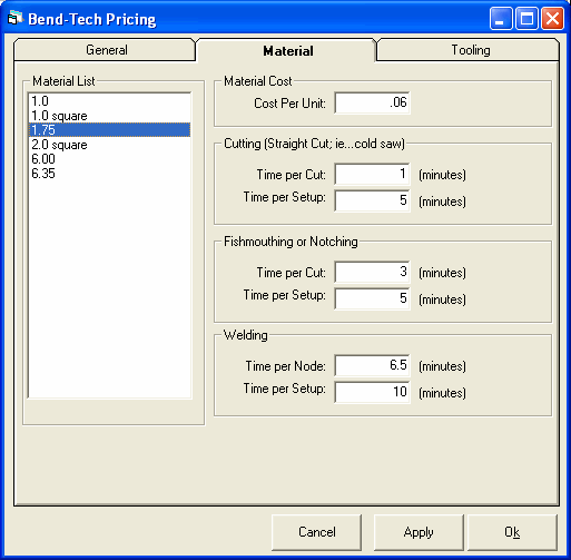

Function: Allows a user to assign cost to material, time to setup and run time to functions such as; cutting, bending, notching and welding. In addition other functions can be added such as; paint, cleanup, sand blast, etc.... A price is than given per hour of labor. In addition, a percentage increase can be given against material and/or time.

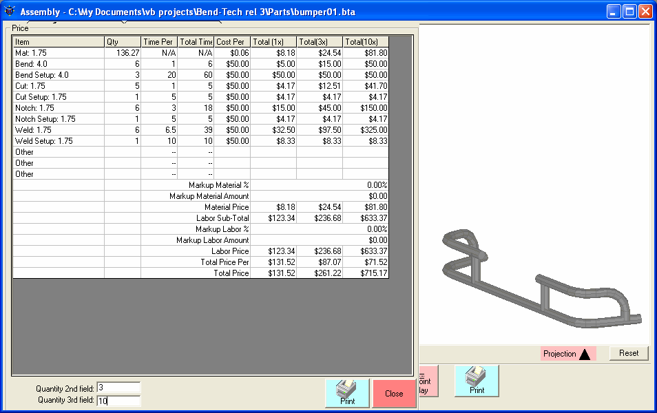

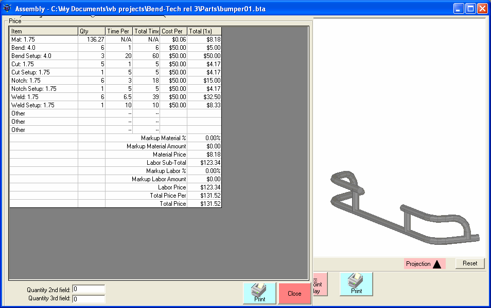

We are going to start with the 3 shots of the Pricing Window. This is where you will find the price and time settings:
In all of the design interfaces you can obtain the pricing results.
Bend-Tech allows for multiple quantities. Find the Quantity fields in the lower left hand corner. Notice how the price per part goes down.

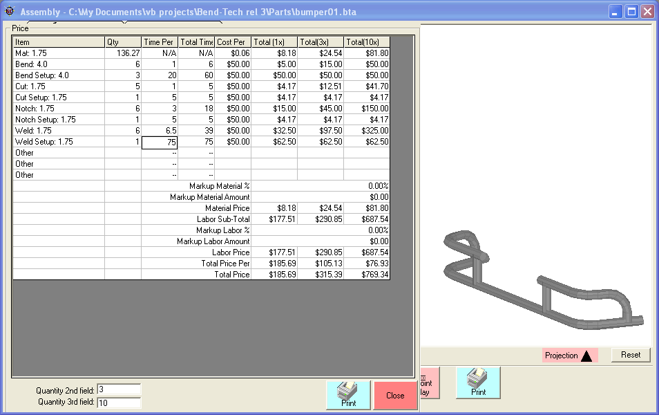

You can change any of fields on the fly; quantities, time per, price per hour, etc...
